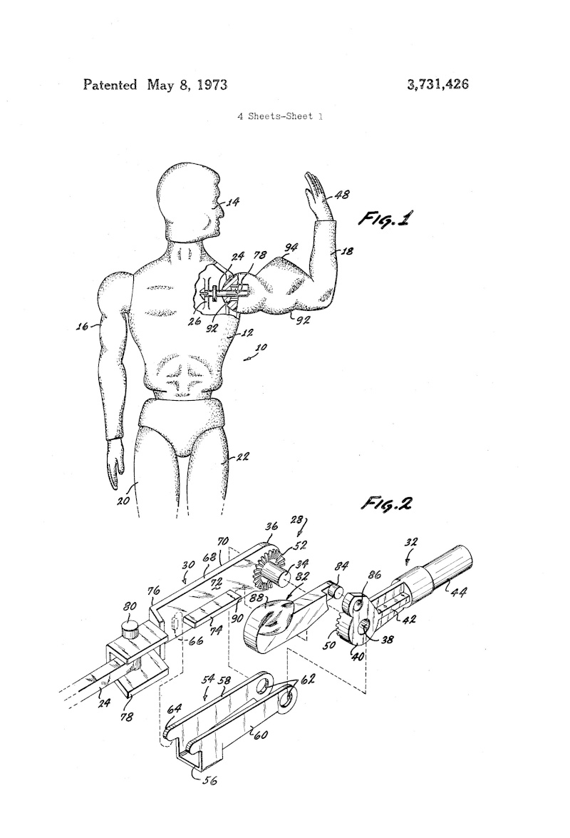

According to a first embodiment of the present invention, a shape-changing figure toy is provided which includes a pair of arms having skeleton-like body members or armatures covered with flexible material.
A non-inflatable, shape-changing member is movably mounted on the body member or armature and is covered by the flexible material. The shapechanging member includes a portion having substantially the shape of an upper-arm bicep. during flexure. The shapechanging member is swung into engagement with the flexible material causing it to bulge when the forearm portion of the arm is swung from an extended position to an upright position normal to the upper arm.

BRIEF DESCRIPTION OF THE DRAWINGS FIG. 1 is a front, elevational view, with parts broken away to show internal construction, of a shape-changing figure toy constituting a first embodiment of the present invention;
FIG. 2 is an enlarged, exploded perspective view of the skeleton-like, body member or armature portion of one arm of the figure toy shown in FIG. 1;
FIGS. 3 and d are side-elevational views of the armature shown in FIG. 2 in two different positions of use;

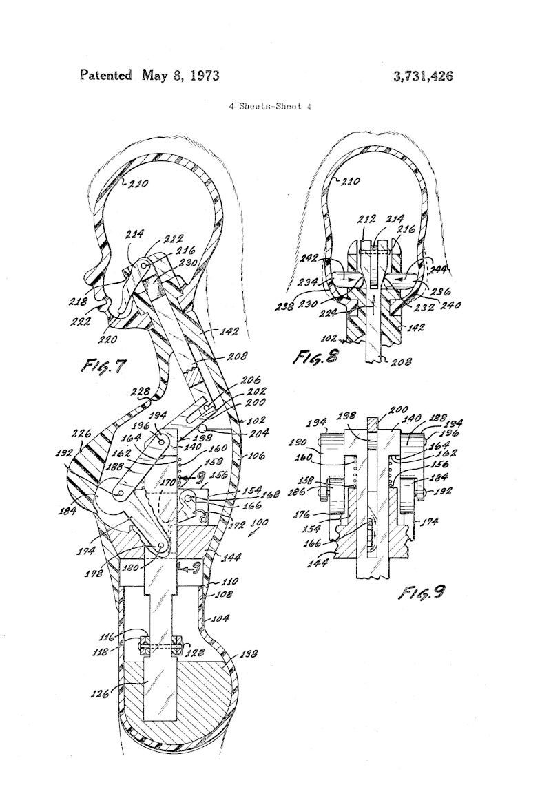

FIG. 5 is a cross-sectional view of a shape-changing figure toy constituting a second embodiment of the present invention;
FIG. 6 is a front elevational view, with parts broken away to show internal construction, of the toy shown in FIG. 5;
FIG. 7 is a view similar to FIG. 5, but showing the internal shape-changing mechanism in a different operating position;
FIG. 8 is a partial elevational view similar to the upper portion of FIG. 6, but showing the parts in a different operating position; and
FIG. 9 is an enlarged, partial cross-sectional view taken along line 9-9 of FIG. 7.
DESCRIPTION OF THE PREFERRED EMBODIMENT Referring again to the drawings, and more particularly to FIG. I, a shape-changing figure toy constituting a presently preferred embodiment of the invention, generally designated 10, includes a torso I2 to which a head I4, and pair of arms l6, l8 and a pair of legs 20, 22 are articulately connected by any suitable means, such, for example, as pin connector 24 connecting arm 18 to a fixed rib or plate 26 provided in torso 12.
Referring now to FIGS. l4, arm 18 includes a skeleton-like body member or armature 28 having an upper arm portion 30 and a forearm portion 32 swingably connected together by a pin 34 integrally formed on an end 36 of upper arm portion 30 and engaged in an aperture 38 provided in end 40 of forearm 32.
Forearm 32 includes a strut portion 42 and a hollow tubular portion 44. A hand-carrying pin 46 (FIGS. 3 and 4) is rotatably mounted in tubular member 44 and carries a hand 4% (FIG. I). A circular rack 50 (FIG. 2)
is provided on end 46 of forearm 32 and is maintained in operative engagement with a circular rack 52, which is provided on end 36 of upper arm 30, by a spring means 54, which may be of the type shown at 2 33 in FIG. of 11.8. Pat. No. 3,277,601 and which includes a crossbar 56 having a pair of fingers 58, 64) extending therefrom. These fingers 58, 60 each includes a loop 62 positioned around pin 34 for bearing against the outer sides of racks 511, 52 forcing them into mutual engagement. The position of spring means 54!- on armature 28 is maintained by an ear 64 carried by finger $8 for engaging a protuberance b6 (FIG. 2) provided on the upper arm portion 341.
Upper arm portion 311 includes a strut 68 having an outer face '79, which carries protuberance 66, and an inner face '72, which carries a shelf member 74. The end 76 of strut 68 which is remote from end 36 thereof carries a U-shaped member 78 to which pin 24 is swingably connected by a crossbar 8i).
Body member 28 also includes a non-inflatable, shape-changing member 82 swingably connected to forearm 32 by a pin 84 which engages an aperture 86 provided on end 461 of forearm portion 32.
Shape-changing member 82 is provided with a bulbous portion 38 simulating a shape of a flexed bicep and normally assuming the position shown in HG. 3 wherein member 82 rests on shelf '74. Member 82 may be moved to the position shown in FIG. 4 by swinging forearm 32 in a counterclockwise direction (as viewed in FIG. 1) until forearm 32 is normal to upper arm portion 36 causing pivot pin 84 to move downwardly so that the bulbous portion 8% is elevated due to the turning of member 82 upon a fulcrum 941 formed by shelf 7d.
I Arm 18 is covered with a flexible covering material 92 (P16. 1) which may be molded from a suitable plastisol material encapsulating body member 2%. Covering material 92 normally assumes the shape shown in FIG. 3 and is caused to bulge, as shown at 94 in FIG. 4, when member $2 is swung to its 1 16. 4 position for simulating a flexed bicep.
In use, a child-user of figure toy 161 may cause the figure toy to ilex its biceps automatically by swinging the forearms of the doll from an extended position to a position wherein the forearms are normal to their associated upper arms.
Referring now to FlGS. 5-9, a shape-changing figure toy constituting a second embodiment of the present invention, generally designated 1111), includes a torso m2 having a lower torso portion 111 slideably connected to an upper torso portion 106 by a substantially cylindrical Waist member 1926* on lower torso portion 104 which is telescopically mounted inside 21 waist portion 11% on upper torso portion 166.
Waist portion 1 M1 is hinged, as shown at 1 12 and 114 in F IG. 6, and is connected to a pair of front actuator links 1 16, 1 153 and a pair of rear actuator links 1211, 122 each having an end 124 pivotally connected to a fixed post 126 by a pin 12%. Additionally, the end 1341 of links 116 and 1211 are connected to waist 1161 by a pin 132 and the end 13 3 of links 118 and 122 are connected to waist 1111 by a pin 136.
Post 126 is supported by a block 1313 seated in lower torso portion 1W! and extends upwardly through upper torso portion 1116 where the upper end 1411 of post 12d is positioned just beneath the neck portion 142 of upper torso portion 106. A frusto-conical block 144 is slideably mounted on post 126 and is adapted to be moved from the position shown in FIG. 5 to the position shown in H6. 7 when pressure is applied to waist 11b in the direction of arrows 146, 148 causing ends 1311, 134 of links 116, 120, 122 and 118 to move upwardly in the direction of arrows 150, 152 (F 16. 6) for moving upper torso portion 11% upwardly with respect to lower torso portion 104.
Block 144 carries an upstanding collar 154 having an upper end 156 against which the lower end 158 of a compression spring 160 is seated. The upper end 162 of spring 161]) is seated against a shoulder 164 provided on the upper end 14 1 of post 126, whereby spring 160 biases block 14-4 and waist 11b to the positions shown in FIGS. 5 and 6. Block 144 and waist 110 may be maintained in elevated positions, such as shown in FIG. 7, by pawl 166 pivotally mounted on collar 154 by a pin 168 and is biased into engagement with teeth 1'70 on post 126 by a spring 172. When block 144 reaches the upper limit of its travel, pawl 166 is relieved so that spring 16 1) will automatically return block 14-4 to its FIG. 5 position.
A pair of shape-changing links 174, 176 have lower ends 173 connected to block 144 by pins lbb, 182, respectively, and ends 1841, 186 connected to links 188, 19%, respectively, by a pin 192.
Links 188, 190 each includes an upper end 194 pivotally connected to the upper end 141 of post 126 by a pin 196 which pivotally receives the end 19$ of a bifurcated link 2M1 having its slotted end 202 resting-on a fixed pin 2%, carried by upper torso portion 106, and stradling a pin 2% carried by an actuating rod 208 extending upwardly through neck 142 into the head portion 216) of figure toy 10b.
Actuatiug rod 2118 has a bifurcated upper end 212 to which a finger 214 is pivotally connected by apin 216. Finger 214 extends through an aperture 218, which is provided in neck 142, so that finger 214 will be moved from the position shown in FIG. 5, wherein end 2211 of finger 214 engages lower lip 222 of head 21%, to the position shown in P16. '7, where finger 214 is freed from lower lip 222, when pushrod 2113 is moved in the direction of arrow 22 1 (FIG. 8 ) by the rocking of bifurcated link 2111? about fixed pin 204 when block 144 moves upwardly swinging links 174, 176 counterclockwise, as viewed in FIG. 5. As links 1'74, 176 swing incrementally counterclockwise, as indicated by the broken lines in FIG. 5, during the stepping of pawl 166 in teeth 177as waist 1141 is incrementally squeezed in the direction of arrows 146, 148, a bulbous protrusion on ends 184, 186 of links 174, 176, respectively, engage a hinged flap 22s, forming part of upper torso portion 1% and swing it from the position shown in FIG. 5 to the position shown in F 16. 7 simulating development of figure toy 1% from a small child to a teenage child. Flap 226 is hinged to upper torso portion 106 by a hinge 2% formed by reducing the cross section of the plastic material forming upper torso portion 1%.
The upper end 212 of pushrod 2&8 includes carnrning surfaces 231), 23 2 which control the movement of cheek-engas" g blocks 234, 236 (FIGS. 6 and 8 ) so that block 234, ass will move from the position shown in HQ. b wherein cheek 232, 240 of head 2111 simulate the fat cheeks of a small child to the position shown in FIG. 8 wherein block 234, 236 have moved in the direction of arrows 242, respectively, permitting cheeks 238, 240 to move inwardly simulating the longer, less pudgey face of a teenager.
