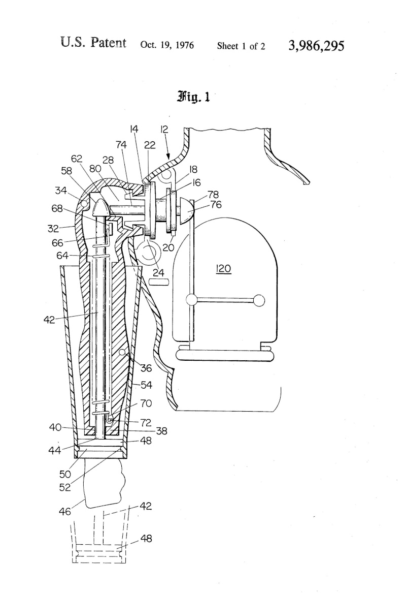

FIG. 1 illustrates in cross-section the elements of the preferred embodiment;

As is shown in the sectional view of FIG. 1, the arm 32 has a hollow inside and contains an opening at its shoulder end and a second opening 40 at a closed free or hand end 38. A shaft 42 is provided which extends from beyond the closed free end 38 as at 44 and has coupled thereto a simulated fist 46 containing a grooved 52 cuff or ring 50. The shoulder end of the shaft includes a head or dome-shaped portion 58 with a base of greater diameter or cross-sectional area than the shaft 42 so as to form an annulus or shoulder 60. A clip 68 is integrally formed on the shaft near the shoulder end thereof and a pin 72 is formed at the hand end of arm 32 integrally with the arm. A helical spring 64 is mounted about shaft 42. The spring has one end inserted and retained in clip 68 and has its other end thereof attached to pin 72. In the retracted position of shaft 42, illustrated, the spring is stretched and exerts a mechanical biasing force urging said shaft to move axially to an extended position in which a substantial portion of the shaft travels outside the arm. A ledge 62 is integrally formed within the shoulder portion of arm 32. The ledge engages shoulder 60 of the shaft dome portion 58 so as to latch the shaft in the position illustrated. A gauntlet or sleeve 54 is of a frusto-conical shape and extends a substantial length of the arm, as illustrated, but is greater in length than the length to which shaft 42 protrudes from free end 38 of the arm in the extended position, as is indicated in dash lines. At its narrower end the gauntlet is coupled to the cuff 52 suitably by one or more protruding lip portions 52 that engage the groove 50. The other portion of the arm, not illustrated, may be joined conventionally through use of pins 36 and 34 and/or suitable adhesive.
Except for the spring 64, all of the aforedescribed parts and those hereafter described are suitably made of a plastic or polymer material with the term "plastic" being presented in the conventional term understood by the layman.
At the shoulder end of arm 32 an inturned flange portion 30 is formed which is used to assist the coupling of the arm to the torso partially illustrated in section 12. In the torso a series of webs 18, 20, 22 and 24 support a journal member 16, which member is freely rotatable. the journal member has a hollow center and a series of hooklike fingers 28. The hooklike fingers engage the external annular flange of the arm on the surface thereof inside the hollow of the arm to hold the arm to the torso. A pin 74 is slidably mounted within the pin journal 16, extends from the torso into the arm, and is sufficient in length to extend at least to the end of ledge 62 for reasons which hereinafter become more apparent. Pin 74 includes a dome-shaped head 76 as shown located in the torso portion.
The ramp or wedge member 78 is included in the torso. Member 78 is mounted so that by pivoting it comes into contact with head 76, as hereafter more fully explained. This actuator member 78 is illustrated in greater detail in FIG. 2.
By way of background, reference is made to U.S. Pat. No. 3,699,713, granted Oct. 24, 1972, and assigned to the assignee of the present application, which patent disclosure is referred to an incorporated therein. The lever mechanism is arranged within the body in the same manner as element 120 in FIG. 1 and FIG. 2 and FIG. 4 of the cited patent, but with the rack 116 removed and replaced by the ramp 78 and with the gear 118 removed and replaced by pin 74. Additionally, elements 104 and 106 in the prior patented stucture illustrated in the patent is replaced by the journal member 16.
Reference is now made to FIG. 2 which depicts the aforedescribed elements in an exploded view. Where the parts have neen illustrated and described in connection with FIG. 1 it is desired to use the same reference numerals to describe those same elements in this FIG. 2. Thus, FIG. 2 shows the arm 32 and the opposite arm part or half 32'. The arm 32 includes the closed free end 38 with the aperture 40 and the pin 72 integrally formed within the hollow of arm 32 and located proximate end 38. the inturned annular flange 30 is illustrated at the shoulder end of arm 32 surrounding the opening at the shoulder end of arm 32, and the ledge 62 which forms a part of the shaft latching mechanism is more clearly illustrated in this figure. The shaft 42 includes the clenched fist 46 at one end as well as the cuff 52 and the integrally formed clip member 68 for retaining a spring end at the other end of the shaft proximate the bulbous shaft end head 58. As is apparent, the shoulder portion 60 of the head 58 is not visible in this figure. The spring 64 is illustrated in its relaxed condition. The dotted lines indicate the placement of the first and second ends of spring 64 on clip 68 and pin 72. The gauntlet is as illustrated at 54. Journal member 16 is seen to have the four resilient hooklike finger members including the two previously illustrated finger 28 and finger 26. As is apparent, when the shoulder is pushed toward the torso during assembly the fingers move radially inwardly as flange 30 presses against the ramplike surfaces of the fingers until the flange 30 passes over the hooklike ends of the fingers. The fingers then spring out and retain the shoulder in place by an abutment with the hooklike end of the fingers and the inner flange portion 30.
The journal includes the cylindrical bearing surface 16a and, as was illustrated in FIG. 1, the surface 16a is fitted within a web which similarly forms a cylindrical surface so that the journal with the attached arm may be rotated. The passage 17 through the center of the journal 16 is illustrated. Pin 74 with head 76 is shown, and ramp member 78 comprising part of the mechanical backplate switch 120 is similarly illustrated. From the foregoing description the manner of assembly of the elements becomes self-evident.
As is shown in the rearward outline figurine view of FIG. 3, drawn to reduced scale, the outline of the mechanical push member 120 which supports ramp 78 is shown in perspective.
Thus in operation the arm 32 may be rotated to various angular positions about the torso to raise or lower the arm. The arm in this respect causes the journal 16 to rotate or if the journal is held fixed the arm will simply rotate by overcoming the frictional resistance between the portions of fingers 26, 28 and the other two fingers, not shown, and the surface of the inturned annular flange 30 forming part of the arm. Assuming that the shaft is in the retracted and latched position as illustrated in FIG. 1, it is seen that the clenched fist 46 is located at the free end 38 of the arm. Assuming the user of the toy depresses the back switch member 120, illustrated in FIG. 3, the member pivots, moving ramp 78 into abutment with dome-shaped pinhead 76 and pushes on same. Pin 74 slides into engagement with dome-shaped member 58 on shaft 42. Pin 74 is sufficient in length and the travel of pin 74 is sufficient to move to the edge of ledge 62 to thereby push head 58 off the ledge, partially deflecting the shaft 42 from the position illustraded, thus unlatching the shaft. Once the shaft is thus unlatched, the force exerted by the stretched spring 64 pulls the shaft from the clip end forward and projects the shaft forward a predetermined length out of the free end of the arm. Correspondingly the clenched fist 46 and the gauntlet are projected out to the extended position with the clenched fist located remote from the free end 38 of the arm and the toy has in effect thrown a punch. By dotted lines in FIG. 1 the ultimate position of the clenched fist and gauntlet are illustrated. As is apparent, the length of the gauntlet 54 is sufficient to at least extend back to the free end of arm 32 so as to obstruct a view of the shaft. It thus appears to the user that the arm length 32 has increased in length. To restore the arm to its retracted and latched position the user simply pushes on the clenched fist 46 to force the shaft back into its position within the hollow arm. In so doing the user stretches the spring. As the domelike head 58 comes in contact with ledge 62 it is apparent that the head exerts a camlike function and while moving forward deflects the shaft 42 from its axis until the head has passed the ledge. Subsequently, due to inherent resiliency in the shaft, the shaft springs back to its normal position with ledge 60 in abutment with shoulder 60. Additionally, if the pin 76 is in an extended position, head 58 similarly forces pin 74 to slide back and the shaft and hand are returned to the normal position awaiting a repeat operation through actuation of the switch member 120 and lever 78.
